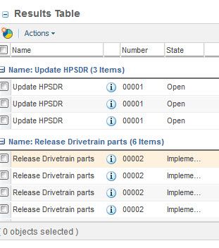

I created a quick report to search for them but it sure would be nice to see and navigate to them. The report did not have (that I could find) the option to view the details (information) page on the object.

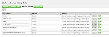

Go to the Select tab and hit the Add button.
Assuming 10.1 is somewhat the same as 11...
Select the browse icon (with the 3 dots)
Change to the correct type and select the first one
This should give you the information icon to go to the detail page.

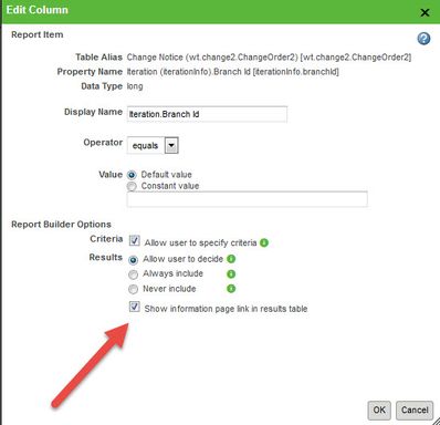

You can display the (i) hyperlink you use the technique in Help - Show information page link in results table
Here is an example:
This results in the following:
