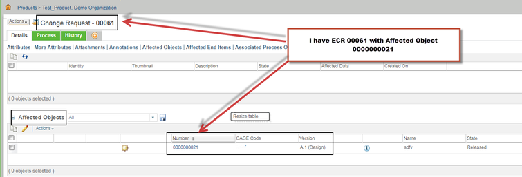

Here is an working example to retrieve AffectedObjects from Change Request:
Consider below UI for reference:
Below is my sample code:
                public static void main(String[] args) throws ObjectNoLongerExistsException, WTException {
		QuerySpec qs = null;
		QueryResult qr = null;
		qs = new QuerySpec(WTChangeRequest2.class);
		qs.appendWhere( new SearchCondition(WTChangeRequest2.class, WTChangeRequest2.NUMBER, SearchCondition.EQUAL, "00061",false), new int[] {});
		System.out.println(" QS :: " + qs);
		qr = PersistenceHelper.manager.find((StatementSpec)qs);
		System.out.println(" ECR Queried :: " + qr.size());
		while (qr.hasMoreElements()) {
			WTChangeRequest2 changeRequest = (WTChangeRequest2) qr.nextElement();
			System.out.println(" ECR Numbar :: " + changeRequest.getNumber());
			wt.fc.QueryResult qr2 = wt.change2.ChangeHelper2.service.getChangeables(changeRequest, true);
			while (qr2.hasMoreElements()) {
				Object obj = qr2.nextElement();
				if (obj instanceof wt.enterprise.RevisionControlled) {
					wt.lifecycle.LifeCycleManaged lifecycleManaged = (wt.lifecycle.LifeCycleManaged) obj;
					System.out.println("" + lifecycleManaged.getIdentity());
Here is what I got as an output:
 QS :: SELECT A0.*
 FROM wt.change2.WTChangeRequest2 A0
 WHERE (WTCHGREQUESTNUMBER = '00061')
joins=null
useBind=true [00061]
 ECR Queried :: 1
ECR Numbar :: 00061
0000000021, sdfv, <object_name>, A (Design)
