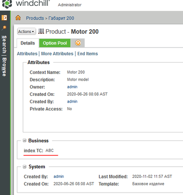

thank you, your solution works if the required attribute is present in Part.
The attribute we need is in the context of "Product".
To use your solution, I added an alias with the name "test" to the Part attribute.
For the "test" attribute in the "Mapping" field, I specified "containerReference^wt.pdmlink.PDMLinkProduct~ИНДЕКС_ТС"
Please tell me what to change the "IBA" to refer to the alias attribute?

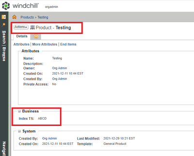

This is doable.
I create the Product attribute Index TS and gave it a value of ABCD.
The OIR uses my custom algorithm to get the value of Index TS from the Product the Part is being created in.
During creation the I logged the running of the algorithm and the value of Index TS.

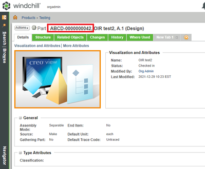

2021-12-29 10:23:26,887 INFO [ajp-nio-127.0.0.1-8010-exec-4] wt.system.out admin - **** Running algorithm ext.customRuleAlgorithm.GetContextAttributeValue
2021-12-29 10:23:26,891 INFO [ajp-nio-127.0.0.1-8010-exec-4] wt.system.out admin - **** INDEX_TS = ABCD
Note: I included a "-" between the prefix and the auto generated number.
Seems to work.
