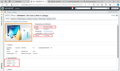

@ukrishnan-3
How does this look?
Notice the attributes were updated WITHOUT iterating the object, this test was done on a WTPart but this can work on an EPMDocument or any object type.
In addition to code used to create the result below, if Name is going to be used to set the value of the three attributes, 'customer', 'emissions' and 'engine', I would consider automating the update of those attributes in the event the object is renamed. Or visa versa, update Name if any of the attributes are updated.  Or maybe make the three attributes read only.
Before
After
