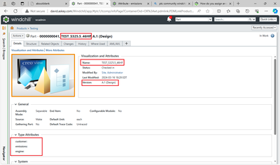

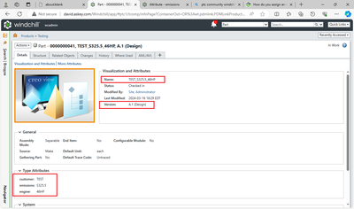

We want to assign the object name 'TEST_S325.5_46HP' to attribute values. We have 3 attributes: 'customer', 'emission', and 'engine'. We assign 'TEST' to 'customer', 'S325.5' to 'emission', and '46HP' to 'engine' without underscores in the object name.
1 REPLY 1
@AR_9920456
How does this look?
Notice the attributes were updated WITHOUT iterating the object, this test was done on a WTPart but this can work on an EPMDocument or any object type.
This was done using some code I wrote per your post.
Before
After
