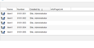

I have added this but not working
ColumnConfig c6= ccf.newColumnConfig("infoPageAction", true); //for i button
c6.setInfoPageLink(true);
c6.setDefaultSort(true);
tc.addComponent(c6);

Thanks @HelesicPetr for reply
but its creating blank column with only name

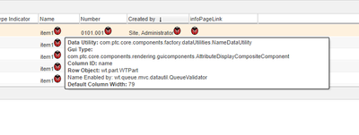

What is your row object exactly. Check it with &jcaDebug=1 option in an URL
You should see something like this
As you can see there is CustomInfoPageActionDataUtility which cares how the info button is shown.
PetrH
Mine showing this
HelesicPetr
(To:RS_10128209)
Column id name? is not correct.

Try to set target object
c6.setTargetObject("part");
and
c6.setDataUtilityId("infoPageAction");
btw. in my case and own tablebuilder, I needed to create own DataUtility that cares about the showing the information icon button. OOTB didn't work for me.
But in my case a row object is oid not part.
