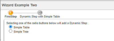

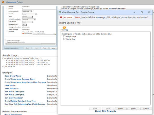

Hi @HO_10736653
Check an example in a catalog
http://serveradress/Windchill/app/#netmarkets/jsp/componentCatalog/wizardComponent.jsp
Wizard Example Two
You just need to use a js script to insert and remove the step. methods are in a main.js
here is an example
function addDynamicTable() {
var showExludeTable = document.getElementById('selectTableline').checked;
 if (showExludeTable) {
    insertStep('PublishTaskWizStep');
 } else {
  removeStep('PublishTaskWizStep');
also you need to define the action in a xml file with attributes
<action name="PublishTaskWizStep" id="PublishTaskWizStep" preloadWizardPage="false" required="false" hidden="true">
