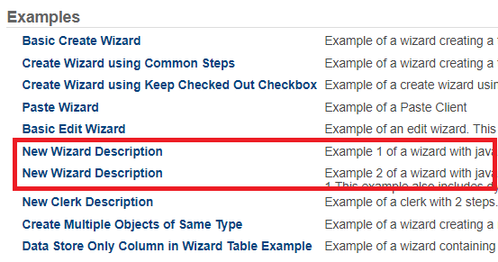

You need to check wizard examples in the Windchill catalog
Examples describes exactly what you need. Show and hide Wizard steps
https://WINDCHILLServer/Windchill/app/#netmarkets/jsp/componentCatalog/wizardComponent.jsp
HelpCenter example 1
HelpCenter example 2
