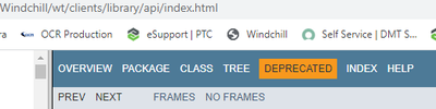

Is there a way I can find all the Deprecated API in Windchill 11 & Windchill 12 Programmatically ?

Typically an IDE like Eclipse and Netbeans will note when you've used a deprecated API with some warning or indicator. Not every class/method is documented in the Windchill JavaDoc but there are some notes there too.
Yes .That's right . However, when the codebase is larger, going through it to identify the deprecations needs some time. If any utility that will scan the code and generate a report comparing to the required  target , will be helpful .

I am trying to identify the occurrences that should give me a report or a count of the deprecated API . That will help me to feed to the Utility and suggest the appropriate solutions reading the method signature , Parameters or alternate API suggested by PTC.  However , this is a tricky case to judge how to use the alternate solution , That's a later part .
Is this achieable?

In my case the IntelijIdea has an analyze function (Run Inspection by Name) which can find what you need all deprecated usage.

I google search pointed this this solution, https://www.sonarsource.com/, which appears to offer tools for scanning and identifying deprecated code. Knowing all the deprecated code in the API may not be all that helpful. As I code, I follow examples of others and sometimes guess at what APIs might be needed. If Eclipse identifies some deprecated methods, which you can have it warn on compile for, I make a note that there should be a newer method I should be using. That does not mean it will not work. This is a process that should be followed with each version change. Like you mentioned, PTC will remove them at version changes. You will then get a compiler failure that you need to fix. I am going through that process now porting my 11 code to 12. Knowing all deprecated code tells me what not to use, not what to use, which is more important.
