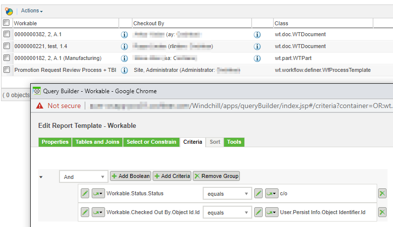

Hi all,
I want to fetch list of all checked out object by specific user through windchill API, can some one help me out?
Input : UserName
Output : Checked-out objects list
Thanks.
3 REPLIES 3
I am not sure of your business requirement for this tool, but just want to confirm if you do not want to do it using report manager? Because it takes a minute to construct this report using Workable interface2020-02-20 11_14_19-Query Builder - Workable.png
Thanks for your response,
but not acceptable this solution.
