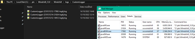

Hi

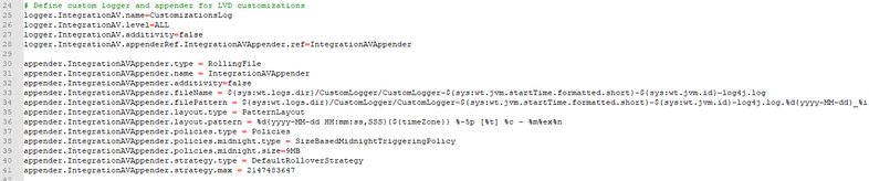

We have a number of customization api's running in Windchill that take effect when promotion occurs. As this is generating a fair amount of logging I decided to put this in a separated log file.
I use next configuration for this (log4jMethodServer.properties):
This creates also a log file for both method server processes (javaMS.exe) and one for the background method server (avaBGM.exe). The loggers with id 21024 & 14912 are method server logs that I do not want. The are empty too.
What am I doing wrong to get these extra logfiles for the method servers? I am only interested in deriving the output from original the BM method server to the CustomLogger.

It is normal behavior, that the log file is created for each MS process.
The log4J configuration file applies for all processes so this is the reason that file is created for all of them.
If you need to create the log file for BacgroundMethod server, you need to separate the log4J configuration for bacgroundMethod server.
in wt.properties find following line where cmd definition is configured for bacgroundMS process.
wt.manager.cmd.BGMethodServer.java.command=$(wt.java.bgmscmd.quoted) $(wt.manager.cmd.common.java.args) $(wt.manager.cmd.common.psm.agent.args.MS) -Dlog4j2.configurationFile\=$(wt.method.log4j.config) $(wt.manager.cmd.MethodServer.jmx.args) $(wt.manager.cmd.MethodServer.debug.args) {12} -Xms{14}m -Xmx{4}m $(wt.manager.cmd.MethodServer.platform.java.args) {11} wt.method.MethodServerMain
rewrite the $(wt.method.log4j.config)  to your new separate log4j config file for bacgroundserver proces: example WEB-INF/log4jBackgroundMethod.properties. In that file you can define your log configuration just for BG.exe.
My suggestion is to create ootb copy of log4jMethodServer.properties file and in the new one add your configuration
Also, I would say that this change you should do by xconfmanager to propagate this change correctly.
