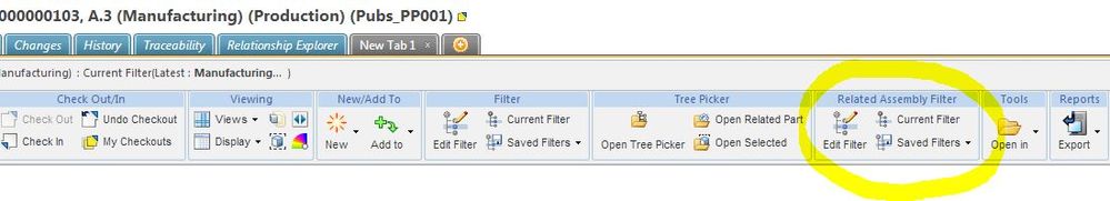

Hello there,
Is there a way to programmatically apply the Related Assembly Filter to the ProcessPlan Structure (Process plan > MPMOperation > Allocated Parts) displayed ?
