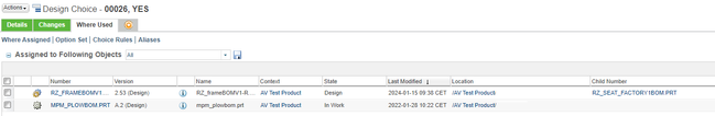

Hi @GrahamV
What Assigned Usage expression are you talking about?
The Assigned Usage Expressions are from the OptionsSets and the API retrieve it as you can see it in the Uses tab in the Structure.
If you use WTReference where you put usage link you will get what is in that usage link assigned.
Or you can put first reference as a parent and second reference as a child WTPart and you would get again the Assigned Usage Expressions
PetrH
Hi Petr,
Yes your image shows exactly what I'm trying to extract, however I can't see how the OptionHelper methods can retrieve this, as it returns an Assigned Option Set not an Assigned Usage Expression, I don't believe you can navigate between these objects (or rather you can't navigate from an Option Set to an assigned Choice, since expressions are really just a set of assigned choices).

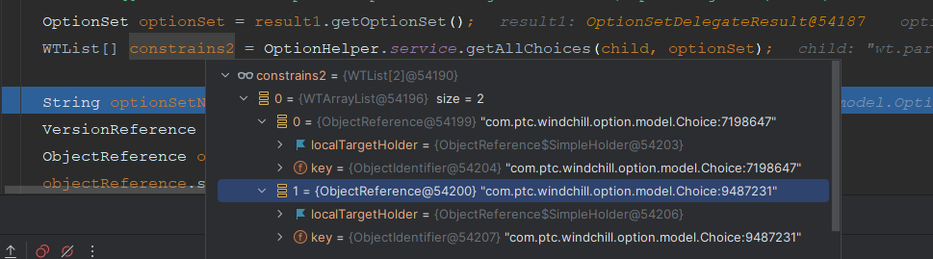

Hi Petr,
Got round to trying your suggestion, this succefully retrieved the choices, many thanks!
I had to do some more work to merge the WTLists into an expression string, couldn't find any OOTB methods to do this but I need something custom anyway (in my use case I need to be able to merge two expressions together), here's what I came up with...
