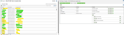

I am creating a report listing task details.
One of the columns in this report is for the "Completed Date" of a task.
I need help implementing a condition for the "Completed Date" column. The condition is:
          If "Work Item.Status" equals "Completed"
               then populate the "Completed Date" with "Wf Assignment. Last Modified",
          else, leave "Completed Date" null/blank.
How can I go about accomplishing this?
Should I create two reports? If so, how do I merge the reports to see both completed and uncompleted tasks?
Is this something that is done under the "Select or Constrain" tab or under the "Criteria" tab?
TIA!

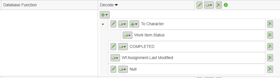

Hi again,
I was able to figure out what was missing. When I would run the report an error was getting thrown about an invalid number.
The result that "Work Item.Status" returns is not a string or a number, its a enumerator.
I was able to add a Database function of "To Character" then under that "Work Item.Status".
After doing this the first value under Database "Decode" can be compared to the second arg which is a string value of "COMPLETED".

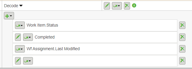

Hi @aaronjlarson,
Thanks for your reply. I am trying out what you described but cannot get a result. Can you let me know if this looks right?

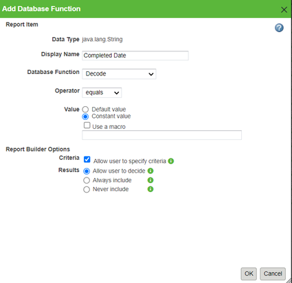

These are the steps I did:
  1. Under Select or Contrain tab, selected Database Function
    1. In Add Database Function modul/popup form
      • Display Name = Completed Date
      • Database Function = Decode
      • Operator = equals
      • Value = Constant value
    2. Under Decode dropdown
      1. Add Reportable Item "Work Item. Status"
      2. Add Constant String "Completed"
      3. Add Reportable Item "Wf Assignment.Last Modified"
      4. Add Constant String "" (blank)
Hi again,
Yes - was just testing that and was going to post same thing as well.  I didn't check that before my first response and since it's an enum you must specify in the internal value, case-sensitive, when specifying as string criteria in a database functino.  I see it works too in my example. Not sure what you're going for, but in my simple test I thought to just use the work item's last modified date as the "Completed Date" if the status is COMPLETED - because if the item is complete wouldn't the completion date be the "last modified"?  Maybe not in your case... anyhow glad you got it working.
