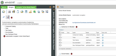

I'm using WC on my browser, and I'd like to use its API to perform CRUD operations, but I'm not able to find the API documentation as described in the help files. Please see the attached screenshot of the location of these files.
I checked my license and looks like REST services is installed.
Any idea why I cannot see the "Client customization" item?
Bert
@BS_10483436  .. Need to set preference.. Site > Utilities > Preference management > Client Customization.. set it to yes .. if already set ... check if any changes made to custom action model

Thanks. I tried to do that, but looks like that option is not available (please see attached). I accessed the Preference Management from: >>Quick Links > My Settings > Preferences. For some reason I can't see the Utilities link/button that you mentioned. If you can share a screenshot of how to access that way, it would help a lot!
Looks like this is the right solution. However, I was not able to see this option since the Admin blocked it for safety reasons.
