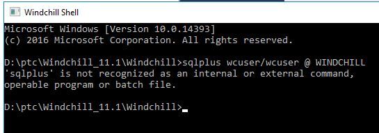

Hello everyone, how to execute sqlplus <db_user>/<db_user_pw>@<sid> command . If there is no Oracle, and there is SqlServer?
And what is @<sid> ?

Thanks, , there is still a problem with sqlplus, how to change the command for SQLSERVER?
It is showing that sqlplus isn't a recognized command, meaning that it isn't installed, not that the syntax of the command is wrong.  The question is why are you trying to use sqlplus via command line and not using SQL Server Management Studio?
BrianToussaint, I can execute SQL commands inside SQL SERVER, I thought that it is necessary to do everything through Windchill Shell that there was a synchronization of files ?

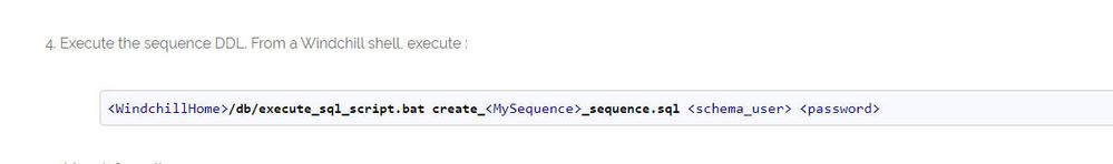

@VladiSlav what are you trying to do?  I do remember when I was creating numbering sequences for new soft types that I created, that it was done through a Microsoft SQL Server Query File ".sql".  If you check out CS42301 on the PTC support page, it will tell you how to do the number sequencing.

@VladiSlav  I sure hope you are on a test server. (I'm not responsible for you trying this and you might want to verify with tech support that is the command you need to use.)  I don't know why they put the .... after SQLServer in line b to run the script.  The command it tells you to use when creating a new sequence as shone in the CS article: https://www.ptc.com/en/support/article?n=CS42301&source=Bloop is as below....
