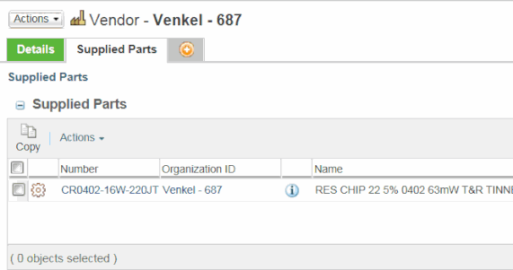

Greetings,
I am just starting the process of configuring Supplier Management.
After creating a few Vendor Parts and selecting a Vendor (Org) for each I have found that I can see all the vendor items from a Suppler (Browse / Supplier List / View info for Vendor / then it shows all the Vendor parts.
What I can not see is a way to view who the Suppler is from a Vendor Part?

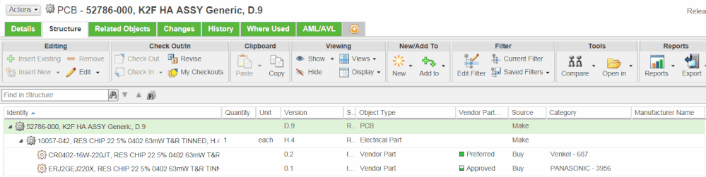

That would be nice if we could see who the supplier was from the Vendor part:

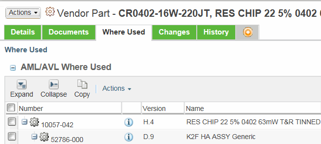

I can add an attribute (category) and manually enter in the name of the Suppler but that seems a little unnecessary when WC already knows the association as I can see the part from the Supplier.
What am I missing?

Opps, the attribute for the vendor is just not added to the view Out Of the Box. I just added it into the news and we are all good.
