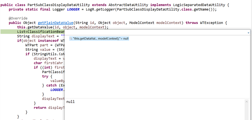

I defined a datautility to control the display text of some Attributes, but when I looked on the attribute tab of the structure Tab, I didn't see it as I saw it on the main attribute page(first Tab). When I debug the attribute of the structure tab, I found that it would enter the getPlainDataValue method of DataUtility. But the first parameter to this method is just the id of the registered datautility instead of the normal component id, so how do I get the original value of the component with datautility set?

You need to implement  LogicSeparatedDataUtility
public class MyDataUtility extends AbstractDataUtility implements LogicSeparatedDataUtility
Then you can use method in your DU
public Object getPlainDataValue(String columnName, Object rowObject, ModelContext modelContext) throws WTException
return ((ConfigPropertiesItem) rowObject).getFileName(); // own object where filename is return as a string
Just use the original function in the getPlainDataValue and convert the value to a String that is shown in the structure
this.getDataValue(columnName, rowObject, modelContext);
PetrH

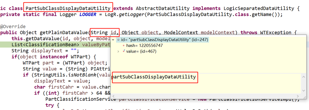

I tried it your way. I couldn't get anything.The ID is still the ID of datautility.As an alternative, I'm going to define multiple DUs, each configured to a fixed attribute.

The getDataValue method takes its first argument from the getPlainDataValue method because getDataValue is called from getPlainDataValue. The problem now is that I can't know the component_id of the attribute that uses this DU, so I can't get the value I need in getDataValue

the ID is forwarded from the system where DataUtility is defined.
So if the data utility is run for attribute name, the ID is name if the attribute is IBA MYATTRIBUTE then the id usually is IBA|MYATTRBUTE but it is not rule. It can be just MYATTRBUTE
so if your ID is null then you did something wrong.
PetrH
The ID is not null.In my experience, when we call a DU, the id is the name of the IBA, but this page,the nameis the selector for DU, and I'm doing DU on this page for the first time, so I'm confusedpic2.png

I would like to know how do you set the DataUtility to attribute and how the servise.properties definition row looks like
because I've never see that ID in getPlainDataValue
my example is for PART_NO
but in the service.properties the selector is PART_NO
