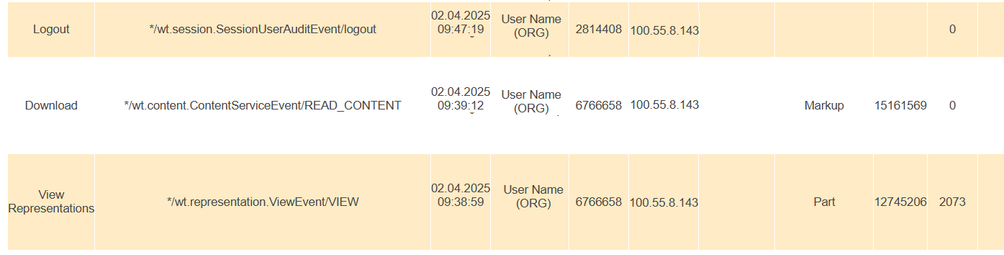

Hi @Ismail.Shaik
You can use following rest api domain to retrieve a login and download event from an AuditRecord
PTC.Administration
[ Base URL: wchserver007:443/Windchill/servlet/odata/v2/Administration ]
The Audit record tracks a download events and login events ootb from Windchill 11.1 + so you can get the information about the number of logins from your service user account.
