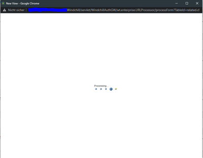

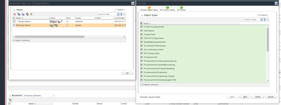

I am trying to make the ResultingFromChangeNotices table editable or in other words make it possible for users to create and edit views.
Currently I am overriding the buildComponentConfig method with the following code
public ComponentConfig buildComponentConfig(ComponentParams var1) throws WTException {
TableConfig tableConfig = (TableConfig)super.buildComponentConfig(var1);
tableConfig.setSingleViewOnly(false);
tableConfig.setConfigurable(true);
tableConfig.setShowCustomViewLink(true);
tableConfig.setSelectable(true);
return tableConfig;
As you can see, i get the Buttons for customizing the views, however the wrong wizard pops up if i try to create or edit a custom view as i can't edit the view's name in the first wizard step as it is possible normally.
When I try to create a view nevertheless, it never finishes loading.
Hi @HelesicPetr, thank you very much for your reply.
I did not find any information in the log-files regarding my problem and decided to replace the whole table with a new custom one before struggling for even longer.
Therefore I created a TableBuilder & -View class. Inserted the new table in the changesTab ActionModel and removed the previous one.

Hi @SubasicDar
Check MethodServer logs. There has to be some information there what failed.
If there is nothing, set the debug level for logging because the processing page is stuck.
There is a reason why it is stuck. you will find it in the log files.
