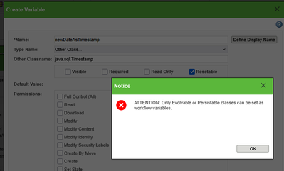

When trying to define a variable as Timestamp (similar to PTC's variables), I get the following error from the Workflow Designer.

Hello @HelesicPetr, thanks for your searches.
It would have been a convenient way for the users but do not want to customize so much. I guess they 'll have to go on related part themselves and set the attribute from there.
I am wondering whether the use of Timestamp (instead of Date) could help  (as PTC uses such variables in Workflow activities. The Workflow Designer does not allow to define a new variable of this type.
