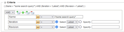

I am currently using a Query Spec to look for all WTParts that match a specific query (query for name or number).
I am also applying a SearchCondition with Iterated.LATEST_ITERATION = true to look for the latest iteration.
spec.appendWhere(new SearchCondition(WTPart.class, Iterated.LATEST_ITERATION, SearchCondition.IS_TRUE), new int[]{index});
I am now trying to expand the query by a latest revision filter since with the Iterated.LATEST_ITERATION = true it returns the latest iterations of all revisions but I only need the latest iteration of the latest revision of this part.
Using the Windchill Search I was able to do exaclty this but I need this as a Java Query. You can see the required functionality in this picture.

To query the object with latest revision and iteration you can use following query :

Thank you @HelesicPetr, your query does exactly what I need, not I will try to merge it with my query to make it work. Thank you!
Hello @HelesicPetr,
while implementing my search conditions i realized that the code posted by you only returns one part of each type - in my case this returns a maximum of one article and one manufacturer part. However I am using a SearchCondition.LIKE with "%"+name+"%" to query for all matches of the name. I tried to figure it out but it won't work.
In this case it should query for all parts that have a match with the search query and return only the latest version (like in your code but for all matches)
Is there a way to do it, is this only a small change to your code or does this require a totally different structure.

Hi @TG_10272716
The select works only for specific one number.
If you need to use LIKE the query needs to be rewritten.
PetrH
Hello @HelesicPetr
could you give me a hint how to do this?
Best regards
HelesicPetr
(To:TG_10272716)
Hi @TG_10272716
The hint is that you need to rebuild the condition with number (or name whateever).  It should looks like as you create subselect in a query builder to filter latest revision.
Now the number condition is in the subselect and search for max value of the BRANCH_IDENTIFIER and the given number together so only one row is returned.
You need to define the condition with number in normal select and set condition for subselect where WTPARTnumber from select equal WTPARTnumber from SUBselect.

My example of QuerySpec is created based on following select
select * from wcuser.WTPart A0
where A0.latestiterationInfo=1
and A0.branchIditerationInfo in (SELECT MAX(B0.branchIditerationInfo) as branchID FROM wcuser.WTPart B0 INNER JOIN wcuser.WTPartMaster B0B ON (B0.idA3masterReference = B0B.idA2A2) WHERE ((B0B.WTPartNumber LIKE N'MV%')))
Example of final select what you need
This select should be rewrite to  QuerySpec.
SELECT A0B.WTPartNumber
FROM wcuser.WTPart A0 INNER JOIN wcuser.WTPartMaster A0B ON (A0.idA3masterReference = A0B.idA2A2)
WHERE ((A0.latestiterationInfo = 1) AND
A0.versionSortIdA2versionInfo IN (SELECT MAX(AA0.versionSortIdA2versionInfo)
FROM wcuser.WTPart AA0 INNER JOIN wcuser.WTPartMaster AA0B ON (AA0.idA3masterReference = AA0B.idA2A2)
WHERE ((AA0B.WTPartNumber = A0B.WTPartNumber)))) and A0B.WTPartNumber like N'MV%'
PS: in the last sql select example I use versionSortIdA2versionInfo instead of BRANCH_IDENTIFIER

Hello @HelesicPetr,
thank you for your help, I would not have been able to solve this without you,  I was able to achieve the desired result by rewriting the search condition for number and adding one for name and using a group by on NAME.
