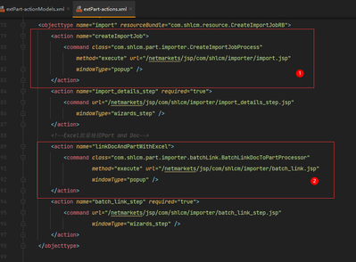

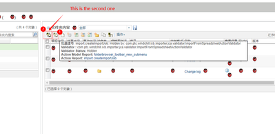

Why does my action is hidden by a validator which I did't wrote it in the action.xml.

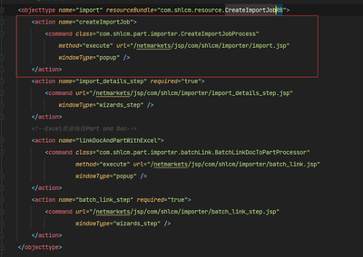

I would suggest du rename the action. There is an OOTB validator defined in codebase/com/ptc/windchill/ixb/ixb.service.properties.xconf
<Option requestor="null" serviceClass="com.ptc.windchill.ixb.importer.jca.validator.ImportFromSpreadsheetActionValidator" selector="createImportJob"/>

I would try to rename the actionModel object type from import to e.g. custImport. Perhaps there is already another model called "import".

I could be the generic action name. You might be picking up a universal filter. You can also try excluding the universal filter:
<objecttype name="navigation" class=""
resourceBundle="com.ptc.core.ui.navigationRB">
<action name="home" renderType="GENERAL">
<command class="netmarkets"
method="servlet/Navigation?tab=home" windowType="page"/>
<excludeFilter name="markedForDelete" />
</action>
I added a another action below the first one. The "linkDocAndPartWithExcel" action do not missing and its filter is not the same as first action.
