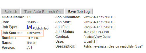

There are several ways to go about this requirement:
publish.republishonepmdocumentchange=true
publish.publishonepmdocumentchange=true
