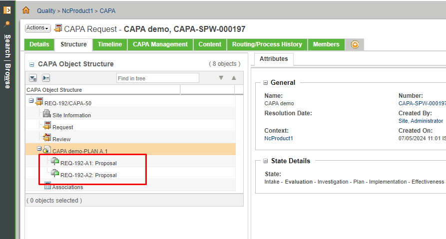

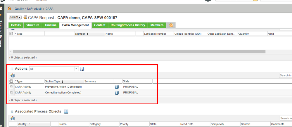

CAPA Request --> CAPA Plan --> CAPA Action
In structure tab you can see that Action are on CAPA PLAN
So I want API to get CAPA actions from CAPA REQUEST
