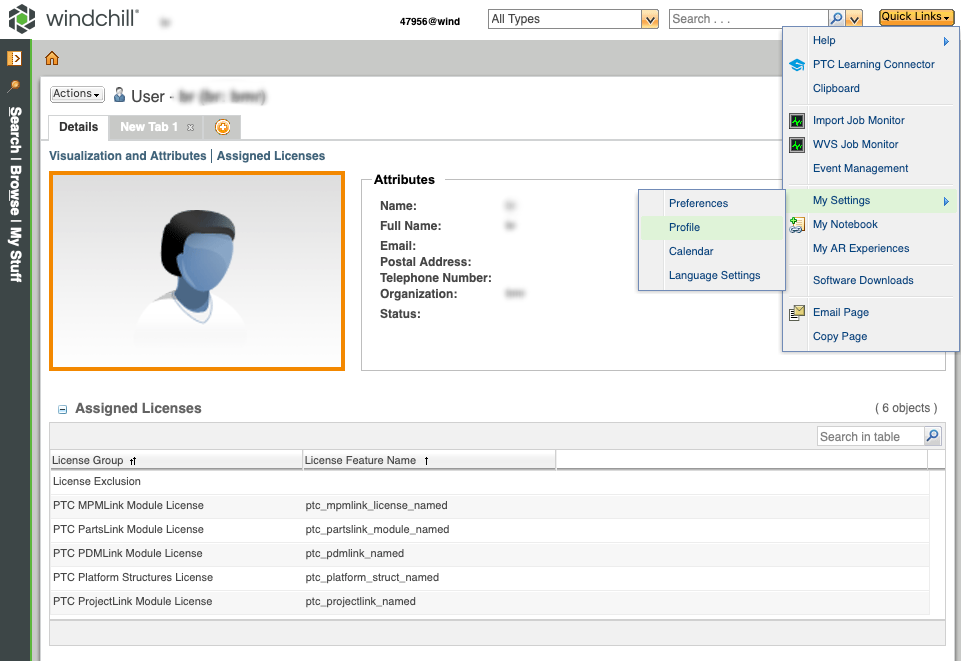

Assigned User License Example
BjoernRueegg
Attached is the source code
