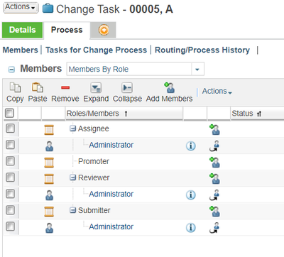

I want to send a task to the manager of that department according to the selected department. Is there any way I can assign this user directly without getting it from the form?

If you solve the mapping what user is in the selected department you can find a user and assign him to a workflow role and the role use in the task,
you need to find a team and a role from a object the workflow is related
Add the participant(user) to the role.
example from Change Task object
generally example API to add a participant to a role is >
wt.project.Role teamRole = wt.project.Role.toRole(roleName); // roleName is a internal name of role what you want to update
wt.org.WTPrincipalReference princRef = null; // you need to find your user and get WTPrincipal object in my case I have a WTPrincipalReference and from this object I fet WTPrincipal -  just for explanation PS: WTPrincipal is a root type of WTUser
wt.maturity.PromotionNotice targetObject = (wt.maturity.PromotionNotice)primaryBussinessObject; // from workflow primaryBussinessObject can be any Change Object Promotion, ChangeRequest, Activity, Notice
wt.team.Team team = (wt.team.Team) targetObject.getTeamId().getObject();
wt.team.TeamHelper.service.addRolePrincipalMap(teamRole, princRef.getPrincipal(), team);
 Adding user to a role has to be done before a workflow task is run.
Hope this explanation can help
PetrH

How can I get the WTPrincipal object?

I couldn't do it I'm getting a Check Syntax error
HelesicPetr
(To:smcvr)
Hi @smcvr
It is normal. The code I provided is not ready for workflow expresion.
Correct all syntax errors.
You need to complete all types with full qualified class names
For example
Object should be withen as java.lang.Object or QueryResult  as wt.fc.QueryResult and so on.
PetrH
