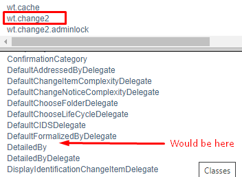

I have the code in an expression robot in a workflow that's called in a phase process. By changing the wt.doc.WTDocument bits to wt.change2.DesignReview (in theory) I'd be set BUT... there is no wt.change2.DesignReview in the JavaDoc (we're on 11.2.1.4).

After some tech support help, it turns out that the design review object is not (yet) available for customization so it cannot be used in code.
