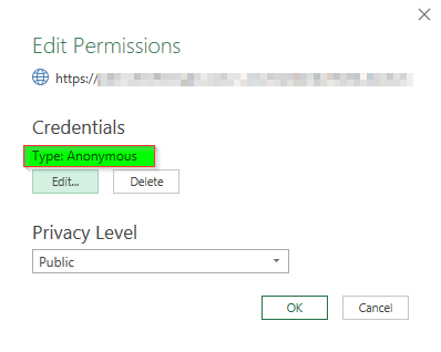

Current BI tools handle HTML pages with ease, however, all of the sudden MS Power BI stopped authenticate.
Simply saying credentials are invalid.
I have tried several techniques and sharing now one that worked.
Anonymous.pngLooks like you need to switch credentials to Anonymous

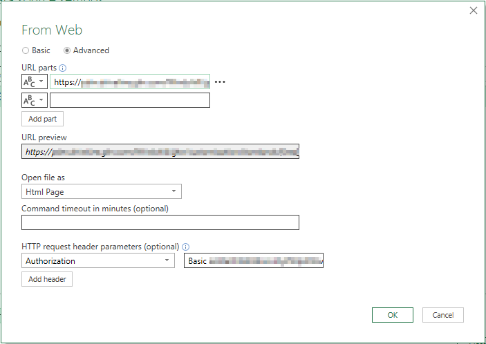

Then authenticate with a special header parameter:
Authorization: Basic user_password_code
Make sure code is preceded by “Basic”+”blank space”

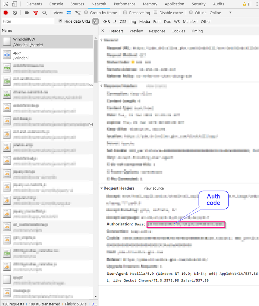

Screens below where to set that, how I get the code, it is my Windchill and Chrome Dev tools (F12).
Now your Power BI authorize successfully.
Con: Your authentication is now within the app/Excel file PowerQuery formula.

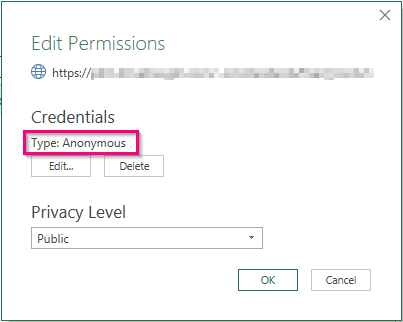

I am getting the below error. It is weird because i am connecting anonymously.
Underlying error code: -2147467259 Table: Table 1.
Underlying error message: The 'Authorization' header is only supported when connecting anonymously. These headers can be used with all authentication types: Accept, Accept-Charset, Accept-Encoding, Accept-Language, Cache-Control, Content-Type, If-Modified-Since, Prefer, Referer
DM_ErrorDetailNameCode_UnderlyingHResult: -2147467259
Microsoft.Data.Mashup.ValueError.Reason: Expression.Error
This kind of error we receive even within Excel when do query copy/paste. For some reason, the engine imposes once upon a time applied Basic authentication, while we would like to use Anonymous + headers to authenticate.Setting needed in Power BI while using headers to authenticateSetting needed in Power BI while using headers to authenticate
