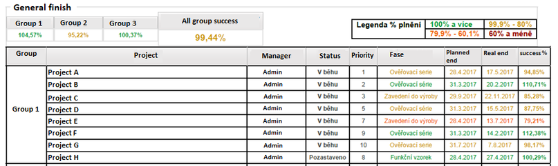

I have a huge task to move from the Cognos reports to the Jasper Reports but I am stuck with some issues with setting in an eclipse
Project Report example in Cognos:
There are several reports in one report.
Also the report is distributed every week to managers by email in PDF format
I will move the reports to a Jasper once 😄
