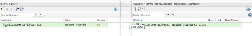

In the system there is definitely that API because it is used in the compare functionHelesicPetr_0-1700573917015.png
but it has not to be just one function it can be a several functions together that compares build status and others information.
You just need to find that API.
