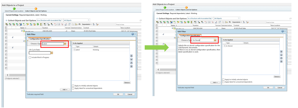

Hello experts,
The customer is trying to make an edit filter in such a way that choose a type by default as "As stored" instead of "Latest" in the configuration Specification.

Hi @VHawal ,
As discussed, its not possible to set a Default value for Configuration Specification for EPM Document structure when sharing the object from Product to Project. Customer can manually Edit the Filter and change it as per their requirement.
