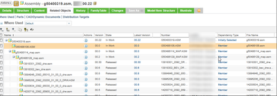

Version: Windchill 12.1
Use Case: Changing the the Default, Latest or other views does not change anything.
Description:
For example, starting with the G50400319.ASM assembly.
The use case tree indicates that this assembly is a member of G50486106.ASM, and that this is the highest level parent
In the same image, other assemblies (e.g. g50486114_map.asm) indicate higher levels.

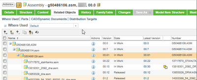

However, if we open the asm G50486106.ASM, there are still 3 levels above
Any thoughts why this happen?
Is there any Report to create a multi level report and compare it with the OOTH Where Used tab?

That definitely does seem strange. I see you're using the "Default" view. Do you get different results when switching the view to "Latest" (or other available views?)
To your question about reporting: No, I don't think there's any other way to report where-used data.

Hi thanks for your reply
unfortunately, changing the Default, Latest or other views does not change anything..
