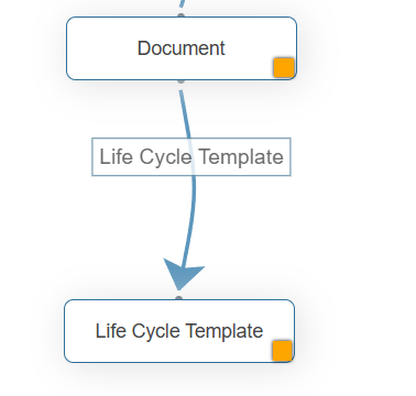

You can also do this using query builder. It's just a join from the Life Cycle Template, to the object:
