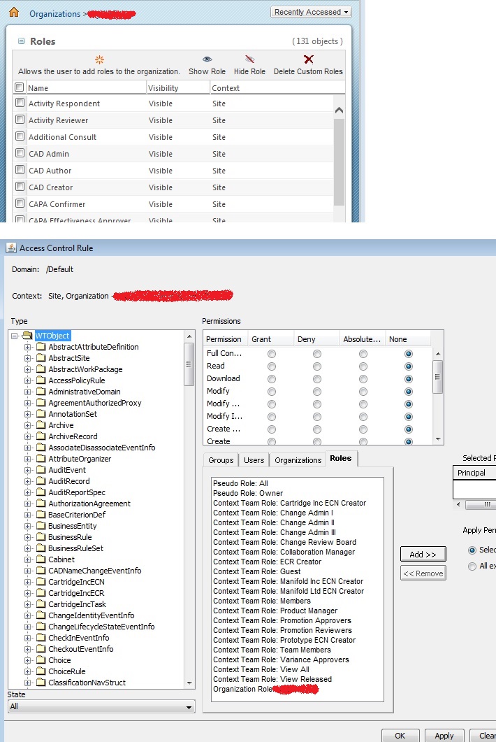

What I don't understand is how you are actually assigning access to a Role.  When I change to the Roles tab there are only 22 entries.  And one of them is the Organization Role: <Company Name>
There are many more roles that that.  How do I get the rest of them to show?

Each Role is "Visible" or not.  OTB, only certain Roles are visible.  Need to go to Org, Roles and make all that you want to use visible.  Also - This ties in closely with the context Teams (not same as Team Instances which exist for each object as it is created via OIR mapping).
The problem is 131 are visible in the Org > Roles area but only 22 Roles show up.  So why doesn't the rest show up?

Show up where?
Did you notice in the org level Roles list there is the ability to show and hide roles? Also, at the product/library/project/program level you can show and remove roles from the Context Team list.
Note, you also have the ability to create custom roles by just typing in a name NEVER DO THIS! Always enumerate your roles so they are available in all role lists. Those not enumerated are not available in all role lists (i.e. workflows, etc)
STEVEG
(To:DanHarlan1)
Hi Dan.  Yes.  There are 131 Roles that are marked as Visible.  But when I go to Policy Administration only 22.
