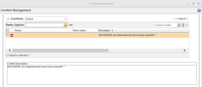

2. What is the problem?
I get the error:        NDI ERROR: two dependencies have same uniqueID "".
But have no idea how to find these two dependencies that are generating this error.  As can be observed, the error does not provide any information about the two dependencies.

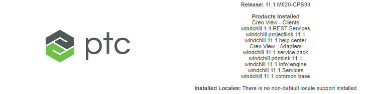

Not sure of the version of Windchill (where do I find this?).
The error occurred when trying to upload or check-in an assembly.  I had incorporated new sub-assemblies and also added some parts to better reflect the actual unit in place on the production floor.  Surprised that Windchill/CREO does not provide an better description of what dependencies are in conflict. Anyway to find this out?  Greatly appreciate any help on this. Also, if you can tell me how to find the version of Windchill I am using, I will get that info.
HelesicPetr
(To:SM_10398034)
Hello @SM_10398034
You need to contact system administrator to check what error is in the log file on the server. From the log you can find what is wrong.
version of the Windchill can be find in a Quick links

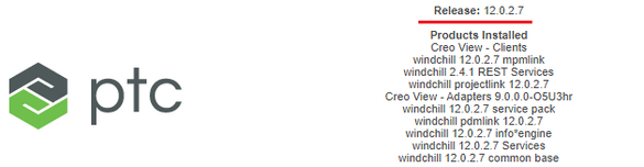

Here is the version I am using...
