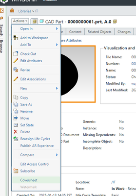

Use Case: I am trying to add the company coversheet to the CAD Parts/Drawings that we have but the error shows "ATTENTION: Failed to add coversheet Cannot find pdf content to apply coversheet for object EPM Document:"
Description:
"ATTENTION: Failed to add coversheet Cannot find pdf content to apply coversheet for object EPM Document:<part_name>"

When clicking on the information page of the CAD part > Actions > Coversheet > (configuration for coversheet) > OK, I get the error that it is unable to find a pdf.

Hi @AQ_10299550
It is Windchill extension app so in your case, there is just an error that the function can not do what you expect.
Exactly the error says that PDF can not be found so the EPMDocument does not have any PDF file to be processed by the tool.
You have two options.
1. Create PDF in a Creo by you as an attachment or generate a Visualization that can create additional PDF file.
There can be some rule to generate PDF by visualization. You have to ask your Windchill administrator who is responsible for this.

So there's actually two coversheet methods for the Wincom extensions. The coversheet with Watermark has to do with applying image based coversheets. Like a CUI coversheet, or a Classified coversheet that has text overlaid.  They also have a coversheet tool (which is the coversheet selection from the actions menu). That is basically a report builder that creates a PDF coversheet.
The Coversheet from watermark was an enhancement Wincom made for us- where a very specific coversheet was required to be added, size, color, formatting etc.
@AQ_10299550 ,
Does this cad model (.prt) even have a pdf?
If yes, show us a screenshot of where you see this pdf.
It would have to be in attachments or a representation not the primary.
As @BenLoosli mentioned, I've never seen this "Cover Sheet" option either but I'd bet big money it uses pdfbox to add the cover sheet.

I think this is the issue. That extension should probably be run on the Drawing, not the Model.
@joe_morton , yeah, I mention that.
A good test would be to add pdf as an attachment to the model and try again.
FYI, I’ve dug into the wincom free Watermark, my recollection is it looks at Primary and published representation for the pdf. Not sure about attachments.
