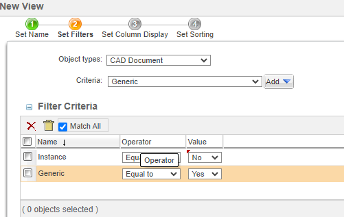

My aim is to create a view, which does not display CAD Part Generic in the table.
At the top of the table, the attribute name appears to be "Object Type Indicator".
However, when I try to define a filter in Edit View, I can't find such an attribute as "Object Type Indicator" in the 'Criteria' list.
In Windchill this kind off Filter in the Edit View is available or not?

You can use attribute Generic or Instance it is up to you.
Object Type Indicator is used only for icons.
