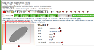

How to create a visualization for EPMDoc
guide_me
9-Granite
Just like this but in a separate page.

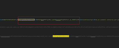

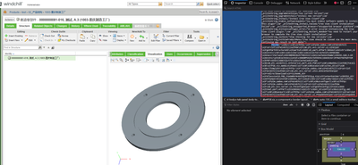

I've tried creo view web toolkit, but it is not supports chrome. And I found a function called PVLite can display the visualization.But this function only works when I give the correct "ncEncryptedCacheSessionId".
PVLite("\x20src\x3D\x27http:\x2F\x2F<%=domain%>\x2FWindchill\x2Fservlet\x2FWindchillAuthGW\x2Fcom.ptc.wvs.server.ui.UIHelper\x2FgetPartStructureED\x3Fpartid\x3D<%=partId%>\x26lstr\x3Dzh_CN\x26levels\x3D\x2D1\x26visnav\x3D1\x26collectorcacheid\x3D502588\x26navcriteriaid\x3D\x2D4006973370491255159\x26ncEncryptedCacheSessionId\x3DwPEpPnQwdyNF0FFqs15RA_3jaOn5QXiwodzeDSIqU25krRuv4_ew_ZAD0DVtkJFN\x26ncCacheCookieType\x3Dcom.ptc.windchill.enterprise.part.psb.PSB\x27\x20\x20webGLClientObjToCall\x3D\x27PSB.viz.WebGLVizPanel\x27\x20\x20locale\x3D\x27zh_CN\x27\x20\x20urltemplate\x3D\x27http:\x2F\x2F<%=domain%>\x2FWindchill\x2Fservlet\x2FWindchillAuthGW\x2Fcom.ptc.wvs.server.util.WVSContentHelper\x2FredirectDownload\x2FFILENAME_KEY\x2FWTSessionId.Op8RWhPw9xhO\x2DgPgaYOMOnUXop8.1c9f\x3FContentHolder\x3DOID2_KEY\x26HttpOperationItem\x3DOID1_KEY\x26u8\x3D1\x27\x20\x20urlbase\x3D\x27http:\x2F\x2F<%=domain%>\x2FWindchill\x27\x20\x20uiconfigurl\x3D\x27http:\x2F\x2F<%=domain%>\x2FWindchill\x2Fservlet\x2FWindchillAuthGW\x2Fcom.ptc.wvs.server.ui.PVConfigHelper\x2FgetPVConfig\x3Foid\x3D<%=prefix%>\x253A<%=type%>\x253A<%=tailId%>\x26lstr\x3Dzh_CN\x26file\x3Duiconfig.xml\x27\x20\x20saveurl\x3D\x27http:\x2F\x2F<%=domain%>\x2FWindchill\x2Fservlet\x2FWindchillAuthGW\x2Fcom.ptc.wvs.server.ui.PVUpdateHelper\x2FlocationUpdate\x3Fu8\x26oid\x3D<%=prefix%>\x253A<%=type%>\x253A<%=tailId%>\x27\x20\x20getetb\x3D\x27false\x27\x20\x20nonce\x3D\x27CSRF_NONCE:Bc1e6sy0dRzOInYzNfQrqOfaP0\x2BLGjFKR7g9p\x2F78F0uLWwB2Y7QYvobMO1OeCSddN\x2F8arfviOCH0E0AEMv1t2PSNTSr3F0wERv5tmZqEL0X3VQVhdZ4sg4naGE\x2F5agNhfZ0opKHFOX\x2B\x2Fd0NCT6Juo73HSA\x3D\x3D\x27\x20\x20configurl\x3D\x27http:\x2F\x2F<%=domain%>\x2FWindchill\x2Fservlet\x2FWindchillAuthGW\x2Fcom.ptc.wvs.server.ui.PVConfigHelper\x2FgetPVConfig\x3Foid\x3DOR\x253Awt.part.WTPart\x253A502531\x26lstr\x3Dzh_CN\x27\x20\x20heading\x3D\x27\u90E8\u4EF6\x20TK000000063\x20\x28\u70E4\u6F06\u5957\u4EF6\x29\x20A\x27\x20\x20linkurl\x3D\x27http:\x2F\x2F<%=domain%>\x2FWindchill\x2Fwtcore\x2Fjsp\x2Fwvs\x2Fedrview.jsp\x3Furl\x3Dhttp:\x2F\x2F<%=domain%>\x2FWindchill\x2Fservlet\x2FWindchillAuthGW\x2Fcom.ptc.wvs.server.ui.UIHelper\x2FgetPartStructureED\x26levels\x3D\x2D1\x26partstructure\x3D1\x26visnav\x3D1\x26visnavjs\x3Dhttp:\x2F\x2F<%=domain%>\x2FWindchill\x2Fnetmarkets\x2Fjavascript\x2Fviz\x2Fviz.js\x26pvdummy\x3Dpvdummy\x26partid\x3DOR:wt.part.WTPart:502531\x26collectorcacheid\x3D502588\x26navcriteriaid\x3D\x2D4006973370491255159\x26ncCacheHostName\x3D192.168.3.64\x26ncEncryptedCacheSessionId\x3Dzf7FcwSt6O_RyGFlxwM601m02jUn2802WIU6QteDYptFtLWxaoBx8\x2Dba_73JtmVl\x26ncCacheCookieType\x3Dcom.ptc.windchill.enterprise.part.psb.PSB\x26renderatstartup\x3Dtrue\x26webGLClientObjToCall\x3DPSB.viz.WebGLVizPanel\x27\x20\x20blparams\x3D\x27com.ptc.FidelityHIGH\x27\x20\x20renderatstartup\x3D\x27true\x27\x20\x20thumbnailView\x3D\x27true\x27\x20\x20isVisTab\x3D\x27true\x27\x20username\x3D\x27\u7BA1\u7406\u5458\x27\x20\x20userid\x3D\x27wcadmin\x27\x20\x20useremail\x3D\x27\x27\x20\x20usertelno\x3D\x27\x27\x20",

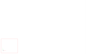

If the ncEncryptedCacheSessionId is not correct, the Visualization will be blank and only an axes are left
