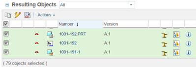

Want to exam the list of Resulting Objects, however, the window size is too small. Each time there are only 3 or 4 objects can be shown. If the list is long, the side scroll bar doesn't care and consistently presents some portion of the list at snail speed.
Is there any way to open up a large sized (popup) window of the Resulting Objects?

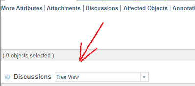

As a side note, you are aware you can make the tables longer? You move your mouse over this line at the bottom of the table.
If this is the only option, I will have to use it. Each dragging move can only open a little bit. The dragging move is always stopped by the border at the bottom of screen. Have to repeat "dragging move down + Roll Up" for many times to open fully. It works though.
You can also collapse other tables on the same page eg the Affected Objects table by selecting the Collapse Table icon "-"
Just move the table up on the page so it's not the last table.
