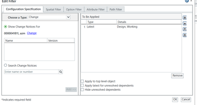

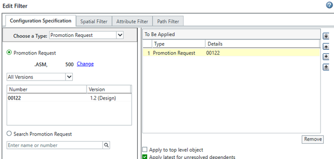

example PR Wizard
example structure filter
