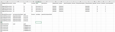

@HelesicPetr  Thanks for sharing,
If i create individual means it's working, but how i can add the attachment individually in primary and secondary content. Refer the below attachments.
I already upload few data through creo, it's shown other format can we do this format in loader.
Aj

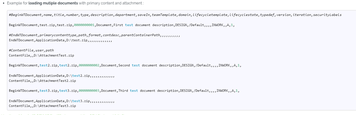

@Amirtharaj_K
What is not clear in the article CS38296
PS> the order is very important.
BeginWTDocument
EndWTDocument
ContentFile
BeginWTDocument
EndWTDocument
ContentFile
PetrH
@HelesicPetr It's a little confusing for me whether I can dump all the files in a zip file or individually. Because there we can see Test.zip,Test2.zip & ,...
Aj
zip is a primary content and the attachment is also zip file in the article example
What is confusing?
You need to define each file individually
BeginWTDocument - defines the object in the Windchill
EndWTDocument - defines the primary content file
ContentFile - defines the attachment file. You can use more ContentFile rows for more attachments but it has to be before next BeginWTDocument definition
the definition order is super important

@HelesicPetr
I think this will help us to understand what i asked.
I create multi-document that name are T1 |  T2 | T3| T4
Each document have a some attachments okay, Example T1 have 2 Attachments one for T1.txt (Primary) and other one is 888505.xlsx (Secondary)
Question: How we can go similar for T2 Document. (Attachments is different)
Question: T3 i can use T4.txt & 888508.xlsx, how we can map it.
Aj

@HelesicPetr Thanks for the reply
For the testing purpose i test it's not work T1 only have attachments other's doesn't have. Kindly correct me if i done a wrong thing.
How we can add the attributes on here.
AJ
Hi @Amirtharaj_K
don't use the empty lines(rows).
PetrH
Thanks @HelesicPetr  It's working. You taught me something new.
