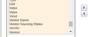

When create a custom view on structure tab by 'Manage structure views', I am not finding Manufacturer name or vendor name to show suppliers of AML/AVL in select column display tab. I am using Windchill 12 OOTB. Is it something restricted in WC12? As I used the same in 11 OOTB and the columns were there for selection in views.

I think @AbbmotionPLM is talking about something different. Since structure table can show AML/AVL parts, these attributes are not IBAs and are displayable:
The vendor name above shows the name of the vendor assigned to the vendor part linked to this component in that supplier context. There might be multiple entries.  Same is true for Manufacturer's name and status. I just fired up my 12 system and can confirm that those attributes do appear:

I faced similar issue in WC 12.1.2.1. PTC provided workaround in below article-
https://www.ptc.com/en/support/article/CS401096?source=search

Ok, looks like they are suggesting using alias attributes but boy is that a terribly written article. Screen shots and examples would be useful.
