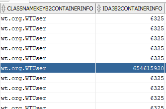

If its not something in the UI, you might have to resort to a database edit. The creator for the Library is stored in the WTLibrary Table. Modeled Object info shows this as the ida3b3containerinfo column.
You need to get the ida2a2 value of the user you want to change it to and copy that number for that library's row. I also think it has to be a real user account, not a group.

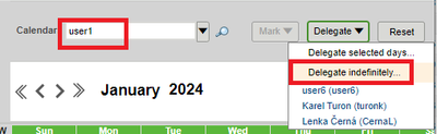

Use a delegate calendar and delegate all work to an another user
Emails could go to delegated person.

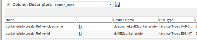

First question, how did you get to the Column Descriptors (like the image shown). That could be a very useful tool.

https://<your  server name here>/Windchill/app/#ptc1/carambola/tools/list
then go to Modeled Objects.

Not Part OOTB , you can give a try and change it using SQL after taking a backup of given table  , the IDA3B2CONTAINERINFO column ,stores the ida2a2 of the product/library creator .
