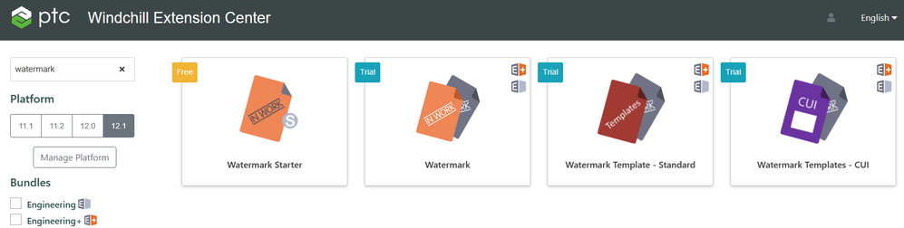

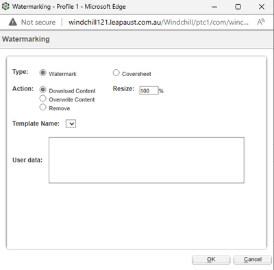

Not able to find the Templates for Watermark extension added for Windchill 12.1, as shown in image.

Which version of watermark do you have installed?
Watermark version is 3.7, which I have download for WC12.1 version. Also, I have added Watermark Template - CUI version 3.0. I am trying to access Watermark Manager, which could not be found on the Windchill Extensions portal.

Which other WEX files are required for creating new templates, and adding pre-defined templates?
I am assuming you are intending to use the CUI Coversheet Watermark?
You need Watermark Manager as well. The latest is 3.10, although it should have came along for the ride with Watermark 3.7.  If you go to Watermark configuration in the Extension Manager, are any of your templates excluded?

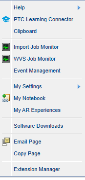

Go to Quick Links in the upper right hand corner of your Windchill and do you see Report Manager? If so, that's where you will load new Watermarks.

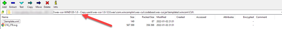

To get the CUI Coversheet, you can go to an old extension download... open it up in 7zip or similar and go to the path indicated. the svg file is the file you would load in Watermark manager to create the Coversheet.

Also, the Report Manager is not visible in the Quick Links drop-down.
