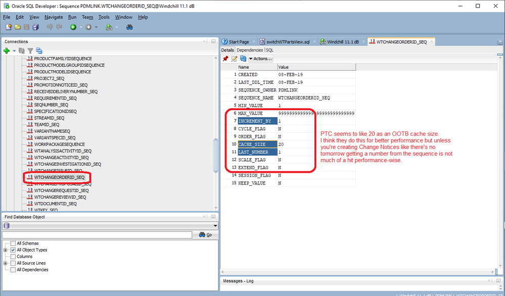

Brain.
Are you using SQL Developer and some other app to look at the dB.
Here's a snap shot of the sequence from an 11.1 dB (11.2 and 12.0 look the same).
Note CACHE_SIZE = 20.
That said, if you have the rule set to 1:1 and they still get thrown out of synch if you create more that one task I'd say PTC needs to work on that.
In the meantime, I'd suggest not using sequence to generate the number.
I do like getting the number of the most recent CN and add 1 to it.
I set the OIRs for both the CN and the Task to key off the most recent CN number.  In short, because the code used to generate the number for both is identical the numbers for both have no choice other than to be identical.
I have not tested my code trying to create more than one task but I'd think you'd get a Uniqueness Exception regardless of the how the rule cardinality was set. And the CN number and the Task number would always be identical.

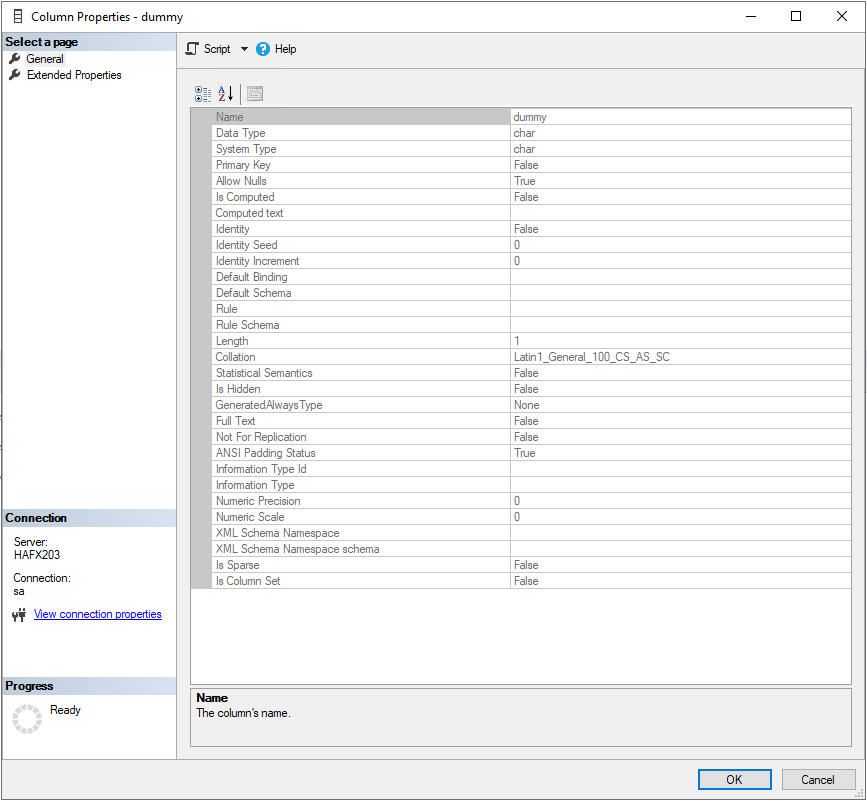

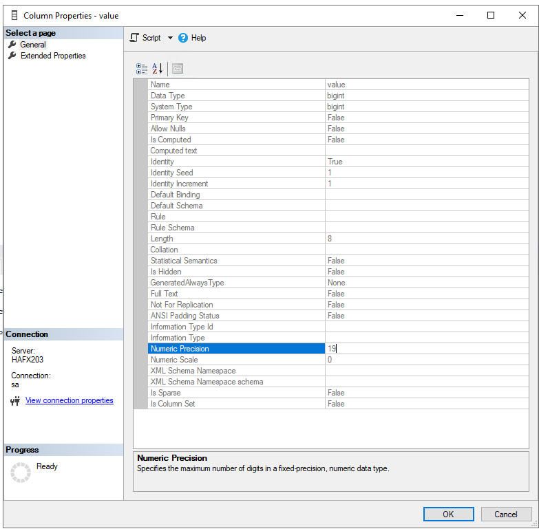

David,
Sorry about not getting back to you sooner.  I needed to finish up my items for Creo 7 rollout over the weekend.  I am getting back to this now as we had it happen again last week.
I am using SQL Server and accessing it through SQL Server Management Studio.  I have to columns in the table. One is dummy and the other is value.  I'm attaching a screen shot of the properties for dummy and value.
Brian
