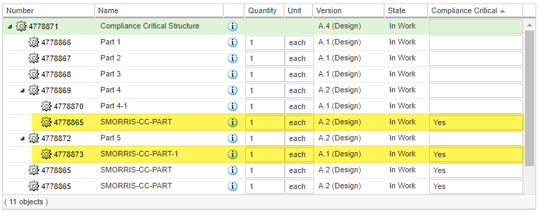

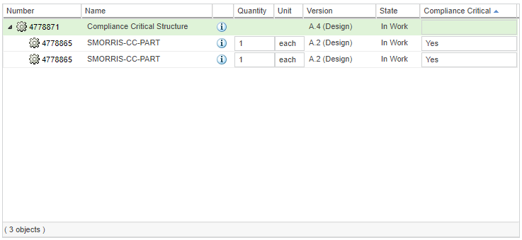

I have a use case where I would like to filter the BOM in the Product Structure Browser (PSB) using an attribute. I assumed this would be a quick and easy way to identify all the components in a structure that meet a certain criteria without exporting the BOM to Excel.
Default Structure Filtering
Attribute Structure Filtering
You can see in the images, the CC=Yes parts at the lower levels are ignored when the filter is applied.

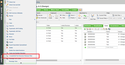

The user selects a custom action that builds the structure filter per the spec. And yes, the spec is built recursively through all levels of the structure.

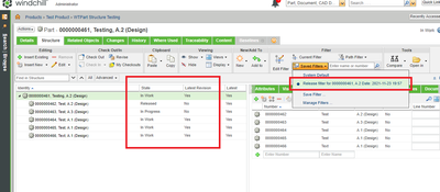

Then they select the filter and display the structure per the spec.
In this example the two states I was using to simulate the released states were Released and In Progress.  Yeah, I know In Progress doesn't sound like released but it's just an example of filtering by state.
