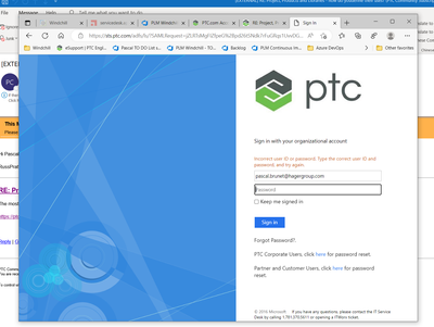

Thank you for your quick reply. Unfortunately my PTC.com account (pascal.brunet@hagergroup.com) doesn't have access. I suppose it is reserved to PTC employees.
