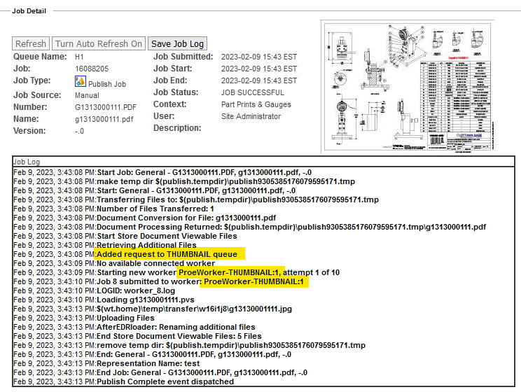

Yes.  Need a separate thumbnail worker.  Might also need some extra wvs properties.  I'd have to double check...

Does this mean that ALL workers will send their thumbnail jobs to this Thumbnail worker?
TomU
(To:avillanueva)
The way I have it configured, no.  The CAD workers each make their own thumbnails.  Only the 'dummy' publish events go through the thumbnail worker.
https://www.ptc.com/en/support/article/CS188172
I'm using option 4 - 'true' for both.
It can be a little confusing since that option is not listed in the help documentation:
https://support.ptc.com/help/creo/view/r9.0/en/index.html#page/creo_view/adapter_install_config_guide/Config-pvsthumb/ThumbnailGeneratorConfigAdvanced/DefaultThumbnailGeneratorConfig.html
avillanueva
23-Emerald I
(To:TomU)
Brilliant!
TomU
(To:TomU)

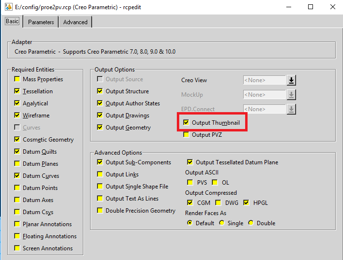

It's probably more technically correct to say that any publish job that doesn't generate it's own thumbnail will be sent to the separate thumbnail worker to have one generated there.
I believe you also have to turn on thumbnail generation in the recipe file for each of your CAD workers.
