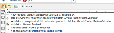

Let's try this, Go to the Product page where the action should exist. add "?jcaDebug=true" to the end of the URL. Send us what you see:
This should tell us what validator is hiding the action.
Hi. Thanks for your support.
The validator is set to "com.ptc.windchill.enterprise.product.validators.CreateProductActionValidator". Whereas the top line of the text in your screen grab says "Enabled By:", mine is saying "Hidden By:".
Next step would be to enable DEBUG logging on that class to see more and then check MethodServer logs.
Ok so I've done this. The MethodServer log produced these two bits of info:
com.ptc.windchill.enterprise.product.validators.CreateProductActionValidator *MYUSERACCOUNTNAME* - WTContainerHelper.service.canCreate: false
com.ptc.windchill.enterprise.product.validators.CreateProductActionValidator *MYUSERACCOUNTNAME* - createProductWizard: hidden
